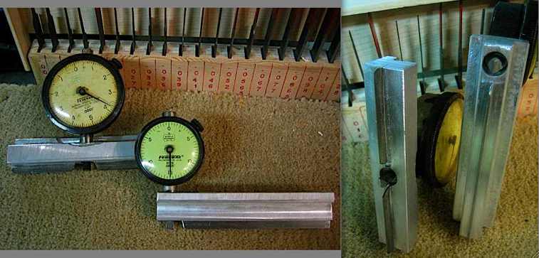

So here are the gauges. I made two styles. The one on the left will measure
the same thing you would view by eye - clearance above the first fret in
reference to the plane from the nut slot to the second fret. The one on the
right will reference from the plane of the frets and read the height of the slot
above or below that plane.
Of course the tools have to be leveled and zeroed out on a surface plate.
The first one (on left) will give a further negative reading for a high nut and
positive for a low one. The second (on right) will read positive for high and
negative for low, and is also twice as sensitive. I used the less sensitive of
the indicators on this one.

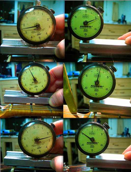

Here is a collage of each reading the same slot. High on the top row, good
(for the particular instrument measured anyway) in the middle, and low at
the bottom row.
With twice the sensitivity and a more meaningful measurement it would
seem that gauge #2 (right) would be more useful. Unfortunately it seems a
little too unpredictable in it's current state. The tip needs to be thin enough
to fit in a .010" slot, and the slightest twist of the tip can throw off the
readings tremendously. I also would have to increase the spring pressure in
the dial a bit to ensure it seats well in any given slot. The first one can be set
much more consistently in place.
